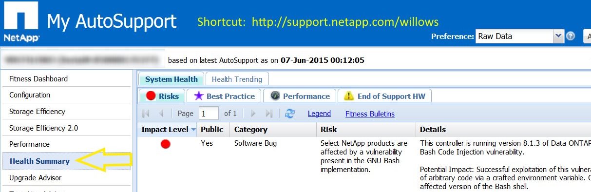

Firmware updates for disks or shelves should be applied soon after their release because of their high risk profile.  You can check the status of your firmware and whether firmware upgrades are recommended by using the Health Summary feature on MyAutosupport, right next to Upgrade Advisor as you've previously used.
