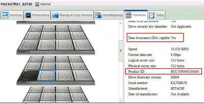

I want to increase the space of disk pool 1. This disk pool is activated DA (Data Assurance)
The state of this hard drive inserted, picture
why aren't unassigned driver list ?

Hello justinfibe,
I can see that the selected drive is not DA capable in the second screen, "Data Assurance (DA) capable: No".
The first screenshot and your description indicate that the disk pool has DA enabled.
You cannot add a non-DA-capable drive to a DA enabled disk pool. You will have to replace the drive with a DA capable drive if you want to add it to the pool.
Team NetApp

justinfibe
8,098 Views
Dears
Thanks for your reply
The current product ID is consistent
The hard disk DA of the disk pool is yes
unassigned disk DA is no

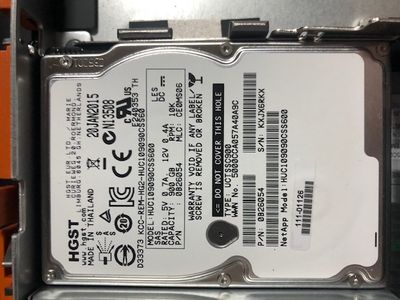

On the unassigned drive's physical label, do you see a part number listed? I am expecting something like the part numbers below.
E-X4038A-R6
E-X4038B-R6
SP-4039B-R6
SP-E4038C
X90-E4038C
Let me know what part number you see on your drive's label.
Team NetApp
justinfibe
8,062 Views
NetApp_AU
8,056 Views
Using your array's name, I found ASUPs for the system.
The drive WWN and SN in the picture do not match the drive WWN and SN for drive in Tray 99, Drawer 3, Slot 1 in the ASUP from Dec. 28. Are you sure the picture you provided is for the current drive in Tray 99, Drawer 3, Slot 1? If it is, I am thinking the drive was not flashed correctly and should be replaced again.
Do you have any extra drives on site with the same drive model that we could try? An unused hot spare from another system could work for testing if the drive model is the same.
Team NetApp
justinfibe
8,020 Views
Currently, the client cannot remove the drive in Tray 99, Drawer 3, and Slot 1 hard drives. Check the drive's label.
The picture above is another hard drive at the scene, and the part numbers are the same as Tray 99, Drawer 3, Slot 1 hard drives
We will try to replace the hard drive again
