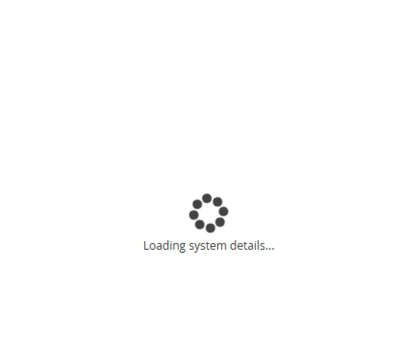

Following the update in 9.3 I no longer have access to system eat on but cluster. I have three bay 2 FAS 2600 and one AFF200 and I have the same behavior. It remains to the load even when doing F5.

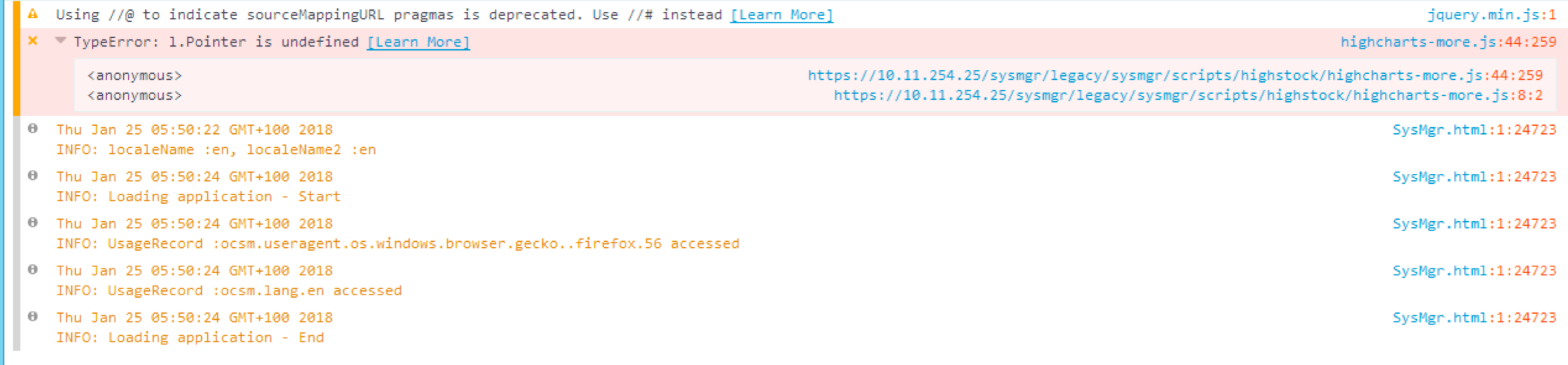

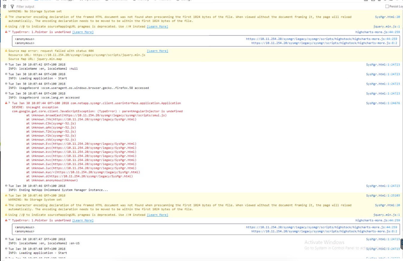

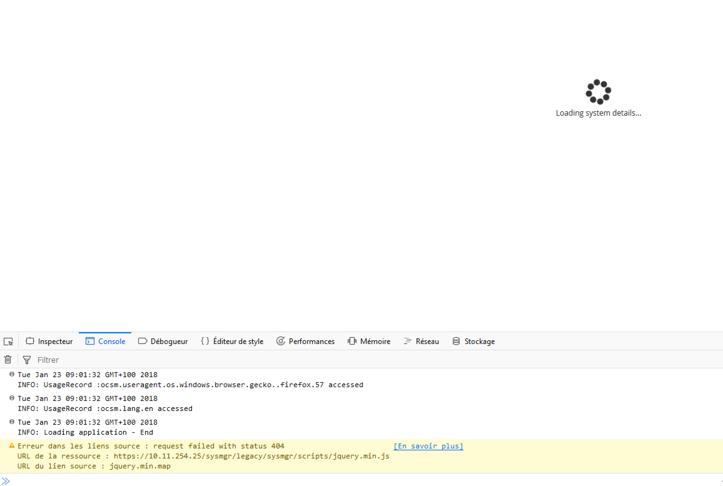

On the other hand, I just found this with the browser console and I have the same error on all bays.

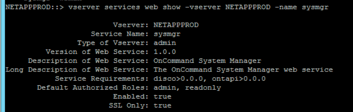

Try command from CLI :
   vserver services web show -vserver vservername -name sysmgr
Could you send me the logs and the output of above command, so that it would be easy to find the root cause?
m_lecoq
23,949 Views
Here is the order
