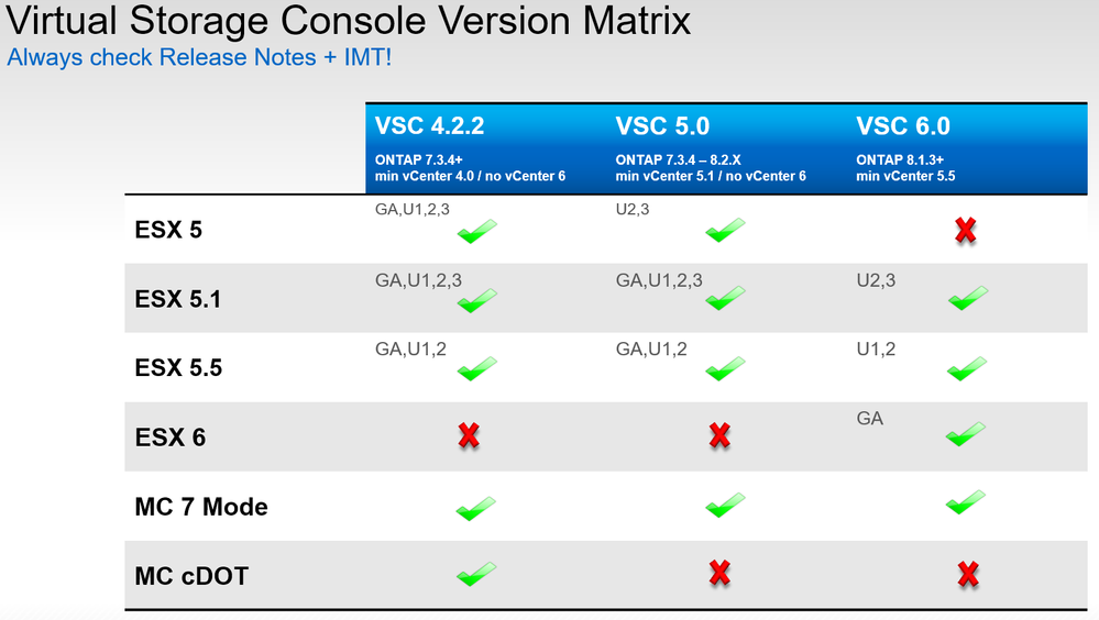

I know this topic is relatively old, I hope that you have found answers to your questions by now.  Just in case you haven't...
Here is a quick matrix of compatibility between VSC, vCenter, and Data ONTAP versions.  Note that this graphic lumps vCenter and ESXi versions together.
My understanding is that you can install VSC 6.0 with your vCenter 6.0, but VSC will have limited functionality with vSphere 5.0.  Once upgrading to vSphere 5.5+, then you should be fine.

I have now managed to roll a setup out our vSphere 6  environment since this post which was quite a while.
I installed VSC 6.0 as the last component. We upgraded to v5.0 to v6.0 from fresh and started with a new vcenter install with existing v5.0 hosts, slowly migrated to hosts to ESXi6 using VMware VUM (Update manager) and then as the final piece installed VSC 6.0 and this worked fine.
